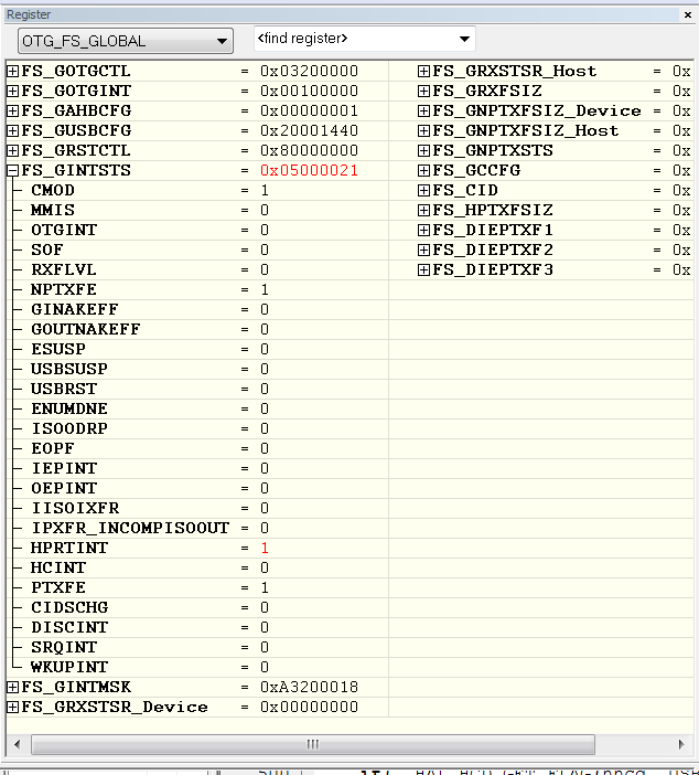

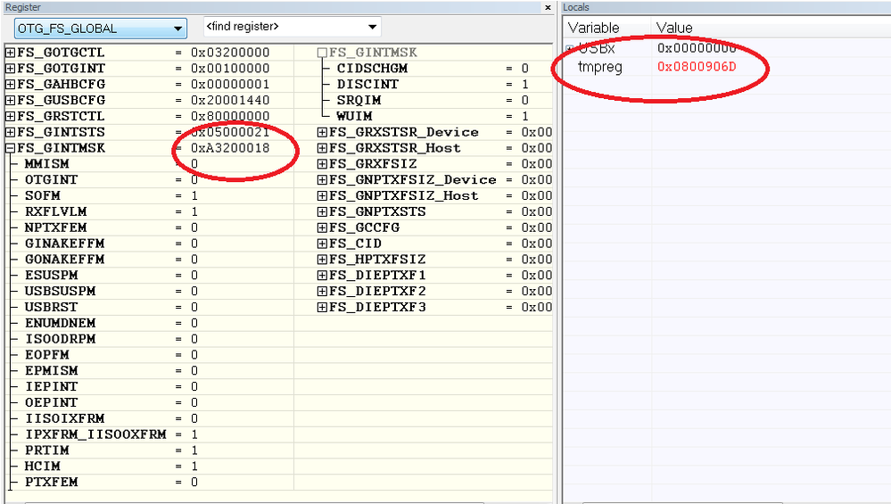

It seems I got it...
the function that chooses between interrupts seems to do not correctly interprete the connection interrup HPRTINT...More correctly the values that I see from Registers tab in IAR debugger do not agree with value assigned by the function USB_ReadInterrupts:We’re moving the ST Community to a new platform to give you a better and more reliable community experience.
