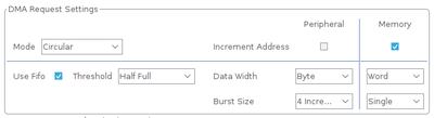

2023-10-24 5:10 AM - edited 2023-10-24 5:17 AM
the limit is fix, "number of data" is a 16 b register.
you just want 8 bit from adc ? so set source to byte,
but if you using the cache and set destination to word (32 b), you could get 64k x4 = 256k byte.
(if it count the destination /32b tranfers - i dont know , just try it ! )

Can't make it work, not even with small buffer sizes. Getting 0,0,0... at all measurements.
