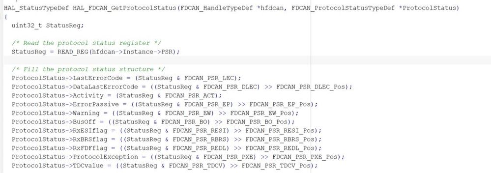

This line:
ProtocolStatus->Activity = (StatusReg & FDCAN_PSR_ACT);I think it should be:
ProtocolStatus->Activity = ((StatusReg & FDCAN_PSR_ACT) >> FDCAN_PSR_ACT_Pos);I'd appreciate if ST can confirm this.

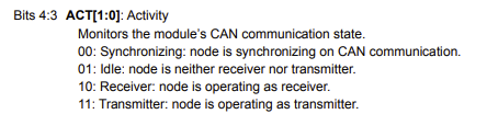

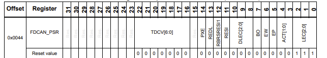

I concur with you findings, in a sense. Activity status are 3 bits to the left and needs a mask of 2 bits.
So adding .FDCAN_PSR_ACT_Pos will shift the bits over to the correct position.
And so the 2 bits represent
but you can't use ST's defines as they are wrong. But would work if you didn't add FDCAN_PSR_ACT_Pos to shift the bits 3 over.
I'd rather ST redo their defines so 0, 1, 2 and 3 are used as it makes sense.

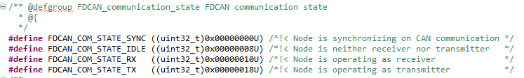

2022-11-22 7:48 AM
ST's defines 0x0, 0x8, 0x10, 0x18 are correct when comparing to activity state. If you use your own defines which are probably 0x1, 0x2 and 0x3, then the comparison doesn't work. 0x0 will work though.
