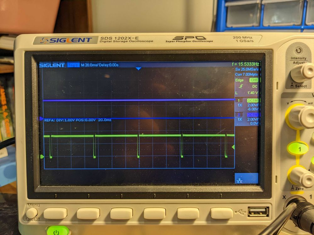

In order to demonstrate the issue, I'll attach a sample project I made in CubeIDE that produces the issue. The program will start with a GPIO set low, and after waiting for short period, will set it high, then jump to the bootloader. On the affected batch of boards (the bottom signal) the GPIO line will dip, indicating a hardware reset. The top signal is the a board operating normally, holding the GPIO high while it waits in system memory:
