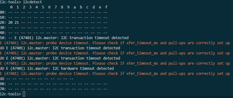

We are using an ESP32-S3 device as the I2C master to communicate with STM32G070CBT processors operating in I2C bootloader mode. We have two revisions (Revision B and Revision Y) of the STM32G070CBT processors.
When probing the STM32 I2C bootloader at address 0x51, Revision B responds successfully without any issues. However, using the exact same hardware and configuration, Revision Y fails to respond, resulting in an I2C transaction timeout:
E (13891) i2c.master: I2C transaction timeout detected
E (13891) i2c.master: probe device timeout. Please check if xfer_timeout_ms and pull-ups are correctly set upImportant details:

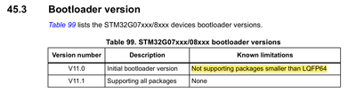

Did you check the bootloader version? There is this interesting note in the version changes.
You could also download the contents of the system flash with STM32CubeProgrammer and compare them.

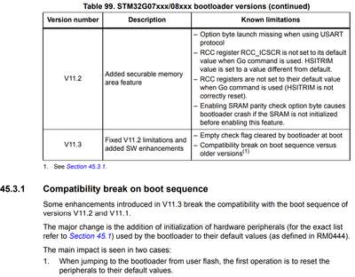

We read the bootloader version using CubeProgrammer. Revision Y appears as v11.3, while Revision B appears as v11.2.
In the AN2606 document, the difference is noted as:
"Compatibility break on boot sequence versus older versions."
As a result, an initialization of hardware peripherals step has been added to the bootloader sequence.
How could this difference impact the behavior?

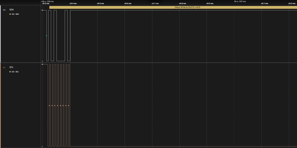

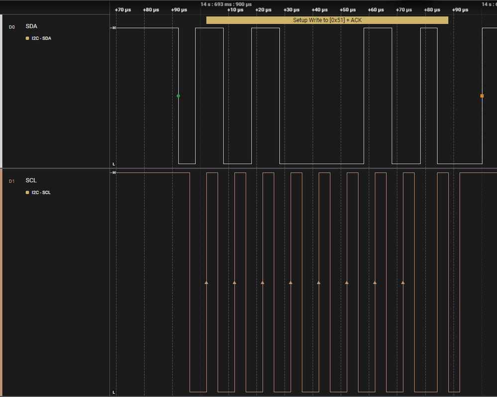

Yes, here are the logic analyzer captures of the I2C lines for both Revision B and Revision Y:
Revision B:
Revision Y:

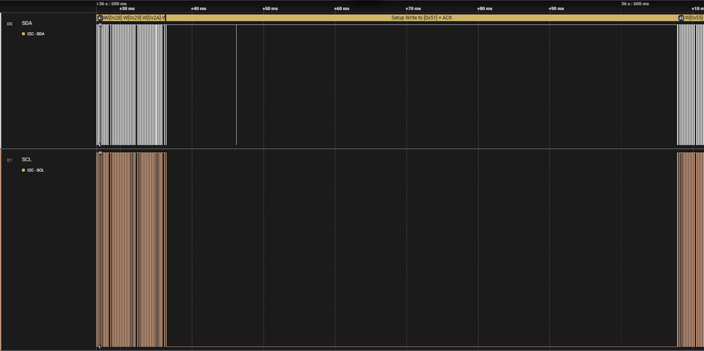

We observed clock stretching on the I2C SCL line with Revision Y.
The tests were performed using the same board by only swapping the ST modules. Additionally, we tested using a different board, and the result remained the same. The behavior consistently persisted.
2025-03-19 4:54 AM - edited 2025-03-19 4:54 AM
Interesting. It looks like rev B also stretches the clock, but only for a fraction of a bit.
I2C doesn't have a timeout though, and it eventually does release SCL after 70 ms and the transaction is successfully ACKd, according to the logic analyzer.
So while the behavior is definitely different, I'm not convinced it's invalid. Can you disable or extend the I2C timeout time on whatever is driving the I2C bus?
2025-03-20 5:22 AM
When we increased the timeout on the device driving the I2C bus, the issue was resolved. However, as you've observed, the SCL stretching duration (around 70 ms) is significantly longer compared to the probes made to other addresses. Are you planning any adjustments or changes regarding this behavior?
