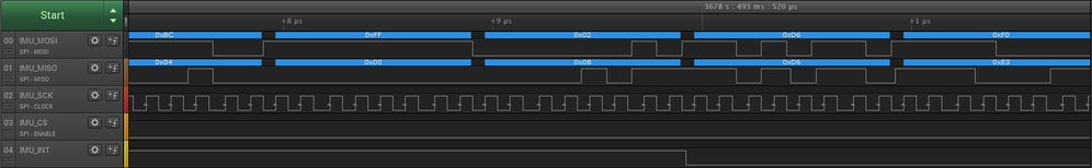

I've got a bit more information on the issue. I ran the test again with a logic analyzer in place. Just before the place where HAL_SPI_TransmitReceive_DMA would return HAL_BUSY, I break and look at the contents of the buffer and the output of the logic analyzer. The following table compares the two:
Here is the output of the logic analyzer:
A couple of observations:
To me, this doesn't seem like a clock issue, since we're not seeing individual bits missing, but rather one complete byte which is definitely being transmitted by the IMU but is never moved from the SPI peripheral into memory by DMA. Interestingly, the next byte starts exactly where it should, which suggests to me that the SPI peripheral received the byte correctly but DMA failed to move it to the buffer.

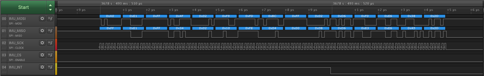

Here is a closeup of the missed byte:
To my eye, there are no obvious issues with the signal here.
What could cause DMA to miss a single byte?
