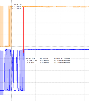

I’m experiencing the same issue, even when using the RX Fifo (which the example does not use by default).
I believe this is happening because RTS flow control is only asserted when either the buffer or FIFO is full. This means that any byte received after RTS assertion will cause an overflow error. However, since RTS isn’t asserted until the previous byte is fully received, if the host is already sending the next byte this byte will result in an overflow.
Here’s an example where you can see RTS assertion in yellow and host byte transfer in blue. The hardware is not asserting RTS until there’s no space left in the buffer, and the next byte received results in overflow.
There’s already a FIFO threshold programmed when using FIFO mode, ideally the flow control would use this to ensure that a byte or two sent after de-asserting RTS would allow the transfer to complete successfully.

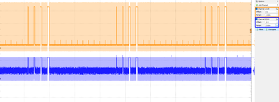

With this change I can insert a variable delay at https://github.com/Trellis-Logic/STM32CubeU5/blob/c3dff424630d16360e91d035726f90c4c1944e7b/Projects/NUCLEO-U575ZI-Q/Examples/UART/UART_TwoBoards_ComIT/Src/main.c#L190 which does simulated processing in the main loop for between 1-14 ms while the buffer transfer itself only takes 10ms. The resulting flow control shows that the host is only blocked for portions of the transfer which occur when waiting for 11, 12, 13, or 14ms, the rest of the time the transfer is fully overlapped with the delay. Also, no bytes are lost and exactly the number of bytes sent by the host are received by the device
