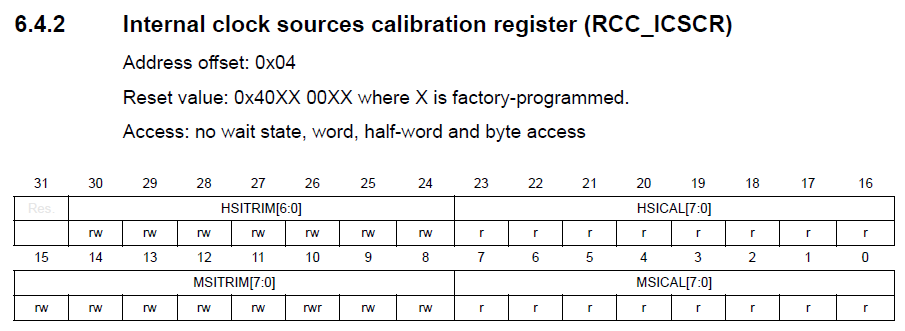

So this checks if HSITRIM is 7 bits wide. which is according datasheet correct:
Now i see the reset value should be 0x40xx 00xx. When i check this register after POR it has a value of 0x10xx00xx. Strange..

The problem comes from the HAL and the RM0394 Rev4 as you said.
This has been raised to the appropriate team for fix:
1. RM0394 should be updated for STM32L43x/STM32L44x devices HSITRIM range.
2. The fix in HAL is planned and will be integrated soon. So, keep an eye out for the coming update.
