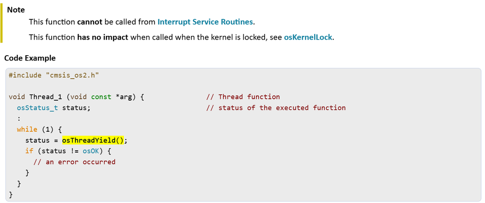

Can you pls explain or pass me a link why osThreadYield() is not needed at IRQ exit but portYIELD() is required?
2025-09-05 5:43 AM
Hello @regjoe
Please look to the link below:
CMSIS-RTOS2: Thread Management
It is mentioned that the osThreadYield() function cannot be called from ISR.
