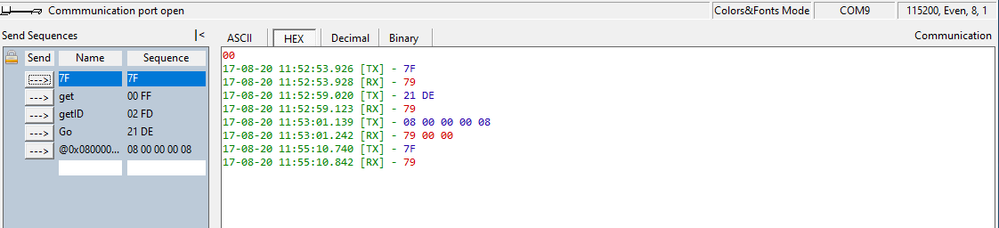

Here a screen shot of what happens from host side:
i start the communication with the bootloader with 0x7F and i get the ACK (0x79)
after that i sent the Go command (0x21 0xDE ) and i got the ACK (0x79) and then i send the address (0x08000000) with 0x08 as checksum and i got the ACK.
what i assume is that the program should jump to the memory address received in the Go command without reseting the board.
