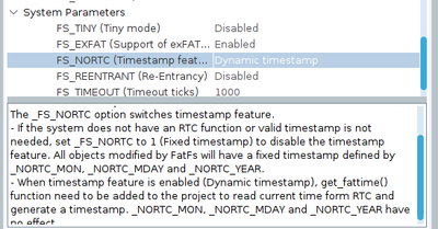

I got the timestamp to work. I had the proper settings in the IOC file but it still wasn't working. I looked around and found a variable in ffconf.h that needed to be set to 1. Line 220 = #define _FS_NORTC 1. It was set to zero. Now I am getting the file created with the time stamp.
2024-01-22 2:26 PM
Actually it's not working correctly. Turns out setting FS_NORTC = 1 bypasses the RTC and uses values set in the ffconf.h file.
I need to figure out how to use the
get_fattime();
