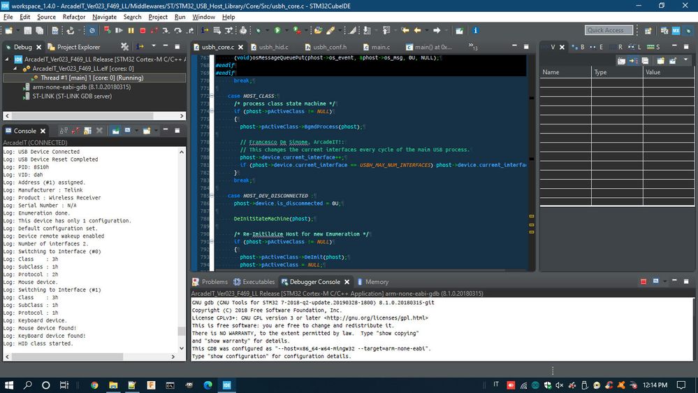

USBH_LL_GetSpeed 1 (LOW=2,FULL=1)I am trying now to modify the ST driver to read multiple interface, but do you have an idea or suggestions ?
2020-10-02 3:31 AM
The work is going further, now the interfaces of the wireless device are detected correctly. The driver still needs fixes because the data coming from the mouse seem to be misaligned. The keyboard is ok instead. When standalone keyboard or mouse are plugged in, everything is perfect. So still a bit of work is waiting for me, but I am getting there. :)

This is true but I can't use external modules.
I have worked all day on this "difference" in parsing data and I have discovered that the composite device has the mouse interface that sends data in a different way than a normal single interface mouse. So I had to dig deeper and it seems to me that this driver from STMicroelectronics doesn't parse the HID report descriptor given by the device, but assumes it to be a standard (I mean single interface) mouse. Things now are getting harder, of course. If I am not wrong, and any help is appreciated, If I want this driver to be able to parse data correctly I need to implement a more advanced parser, so that it can collect data correctly from the device.

Thank you for your suggestion, actually in the beginning I thought about using an HUB to support both keyboard and mouse, but since I am going to release a Kit, www.acadeit.net that has a particular look, I don't like really the idea of having many cables around. In any case a wireless composite Keyboard Mouse is a good solution, even esthetically. Currently I got it working perfectly, so as soon as possible I will share the driver.
