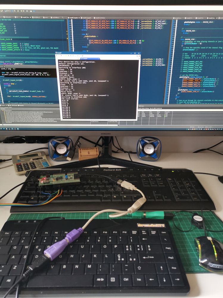

I had an interesting test with STM32F4HUB code on the Discovery F4. Since all keyboard and mice that I have didn't work together through a HUB, I tried to understand if combo devices could work better, and I got an interesting surprise: do you remember those old adapters USB to PS/2 for using PS/2 Keyboard and mouse on one USB port? Good, that worked!
Not only with PS2 devices but also with USB kyb&mouse through a PS2 to USB single adapter on each end.
So I was able to use the USB keyboard and mouse through those adapters , see attachment. There are still some weird behaviors when resetting and starting the Discovery, but when the firmware doesn't "freeze" it works perfectly :)
What do you think?
This is the log text of the STM32F4HUB terminal:
APP RUNNING...
MCU-ID 10076413
HAL_HCD_MspInit
USB Device Attached
USBH_LL_GetSpeed 2 (LOW=2,FULL=1)
addrd: 0x00, pipe: 0
addrd: 0x80, pipe: 1
USBH_ParseDevDesc
12 01 01 01 00 00 00 08
Enum mps: 8, addr: 0
USBH_ParseDevDesc
12 01 01 01 00 00 00 08 B4 04 81 80 06 01 01 02 00 01
PID : 8081h
VID : 4b4h
Address (#5) assigned.
USBH_ParseCfgDesc, number of interfaces: 2
itfclass 0x03
USBH_ParseInterfaceDesc, itf 0, class 0x03, subclass: 0x01, proto: 0x01, numep 1
itfclass 0x03
USBH_ParseInterfaceDesc, itf 1, class 0x03, subclass: 0x01, proto: 0x02, numep 1
Manufacturer : Cypress
Product : PS/2 to USB Adapter
Serial Number : N/A
Enumeration done.
This device has only 1 configuration.
Default configuration set.
INTERFACES: 2
Switching to Interface (#0)
Class : 3h
SubClass : 1h
Protocol : 1h
HID LEN 65 - 0
KeyBoard found.
addrd: 0x81, pipe: 2
IN size=8, num 2, addr 0x81, pool 10, lowspeed? 1
Switching to Interface (#1)
Class : 3h
SubClass : 1h
Protocol : 2h
HID LEN 52 - 1
Mouse found.
addrd: 0x82, pipe: 3
IN size=4, num 3, addr 0x82, pool 10, lowspeed? 1
HID class started.
KEYB 10
KEYB 0
KEYB 17
KEYB 0
BUTTON 0
BUTTON 0
BUTTON 0
BUTTON 0This could be an easy solution to use those old devices also :)
2020-09-17 4:28 AM
Nice. Cypress is a good company, their stuff is reliable.
By the way, once we've made a STM32F4 based host for USB keyboard & mouse and PS/2 keyboard and mouse - all in one.
It was kind of a KVM switch. For the remote (device) end I wanted to use these PS/2 to USB adapters, because they are LS and very compatible with everything.
-- pa
2020-09-17 6:00 AM
Okay, but this is not a hub, but a 2-interface single HID device.
