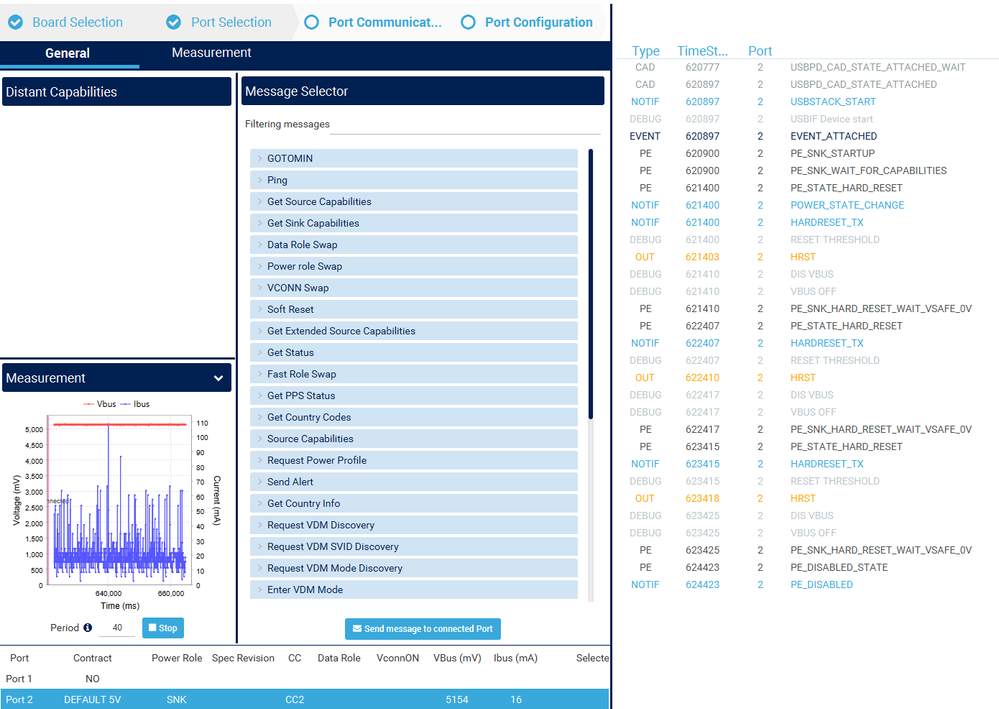

And after 3 hard reset (to try to wake the source up :) ) he believes that the source is not PD compliant. There is no panic :)
You can see in picture below what is normal behavior.
Do you have the same trace ?
Then reading TYPEC_VSTATE_CC value in register UCPD_SR, you can know what is the Rp set by the source.
Hope this helps.

Yes this is normal. Your device gives the source the chance to send the source capabilities, if it can.
Hope this helps.

Yes my program flow follows the same path as your trace shows. That clears it up a lot, thanks!
