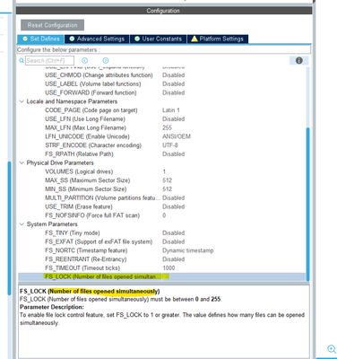

Hello @MauFanGilaMedical
Yes, it is possible to open multiple files simultaneously using FATFS. The number of files can be set via the FS_LOCK parameter in STM32CubeMX.

@MauFanGilaMedical wrote:I did a first try but processor goes into Hard_Fault ... I supposed that I cannot open two files.
Did you make the configuration change as @Saket_Om showed?
Did you regenerate & rebuild the code?
Are you checking for the FR_LOCKED error mentioned in the FatFs documentation?
