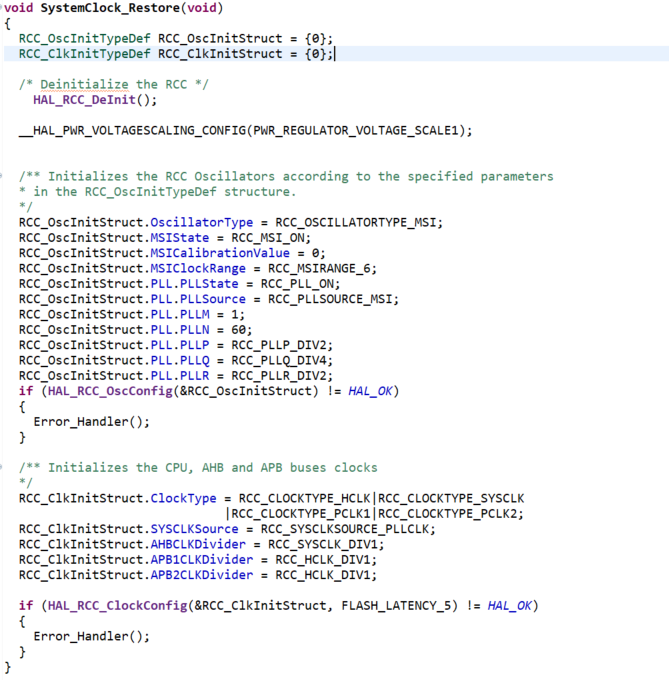

So, to avoid opening the media fx_media_open() in 1 minute it is necessary to restore (enable) the clock (PLL, msi) after low power.

2022-09-21 8:43 AM
hi @MD'Si.1
Here is the scenario:
1 Open Nor Flash media. “nor_disk�?
2 Open a file and write data.
3 Flush media
4 Close Nor Flash media. “nor_disk�?
5 Enter STOP mode.
6 Wakup from STOP mode.
7 Configure clocks for PLL, msi
8 Open Nor Flash media. “nor_disk�?
9 Open a file and read data.
10 Close Nor Flash media. “nor_disk�?
Thanks,
Maher
