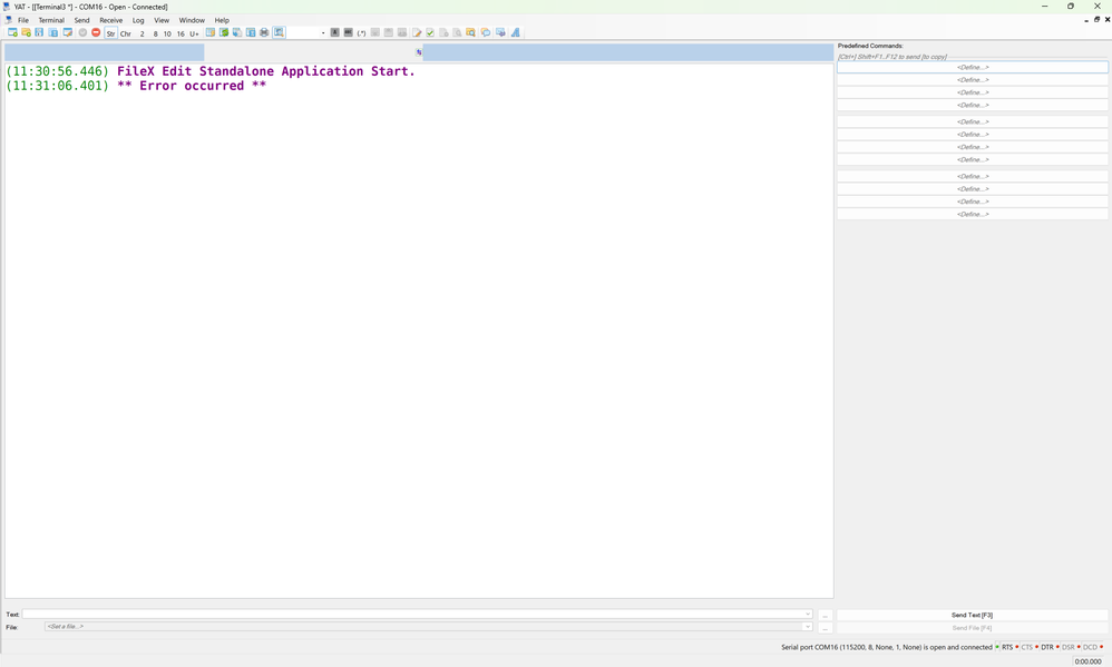

The code fail on fx_media_open returning Error_Handler after 10 seconds timeout.
What is the problem?

2026-03-06 5:39 AM
Hello @alessandromauro ,
During debugging, could you please share the exact return status from fx_media_open() (the error value) before Error_Handler is called?
Regards,
