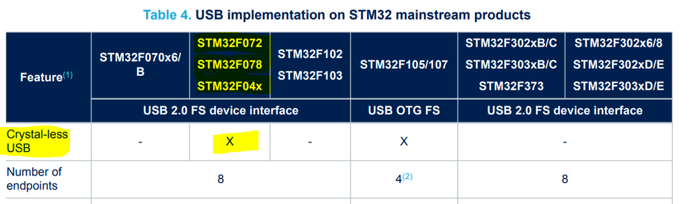

2021-05-03 11:00 AM
Some STM32F0 chips support crystal-less USB. Otherwise you need a crystal to adhere to timing requirements.
2021-05-16 9:31 AM
Ok I can see some STM32 MCU are having internal USB oscillator.
Please confirm and correct me if I am wrong in getting proper configurations & settings, I am currently using STM32F730V8T6 so does it require external oscillator for my usb related operations.
Please confirm me for the same.
