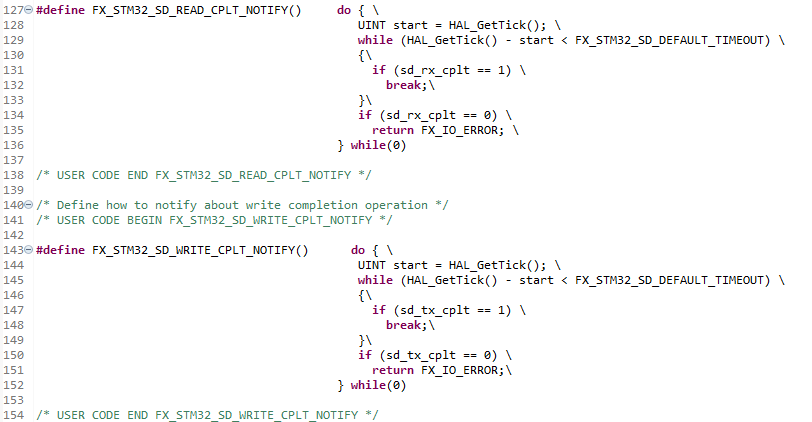

Thanks @cm0x4d for the prompt reply,
Could you please share how did you lower your SDMMC clocking, that I can test in the same conditions as you?
for the "wait for completion" it is not missing :smiling_face_with_smiling_eyes:, it is implemented here.
and here:
so maybe the default timeout should be increased, after lowering the SD Clock?
regards
Haithem.

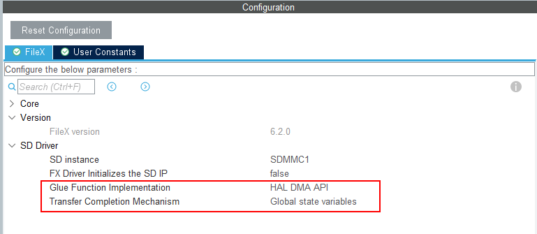

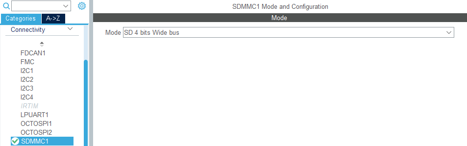

2023-04-07 12:37 AM - edited 2023-11-20 8:23 AM
Hi @cm0x4d
going to check with lower SDMMC Clocking. Meanwhile I checked the using STM32CubeMX 6.8.0 and the code is correctly generated. Below are screenshot of the configuration steps.
Haithem.
