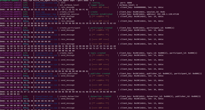

@tapererwaj I was able to get micro-ros with UDP transport working on the NUCLEO-F767ZI.
You can see from the screenshot i could create a node and a dummy publisher. I used this sample file. Its a bit incomplete as the microros function prototypes are missing on the top, because of that a bunch of undefined references errors were coming, Once they were added i was able to communicate to the ros agent
