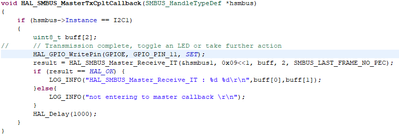

I placed the code to turn on the LED inside the function:
HAL_SMBUS_MasterTxCpltCallback(SMBUS_HandleTypeDef *hsmbus);
However, I am unable to receive a response when using the following receive function:
HAL_SMBUS_Master_Receive_IT(&hsmbus1, 0x09 << 1, buff, 2, SMBUS_FIRST_AND_LAST_FRAME_NO_PEC);"

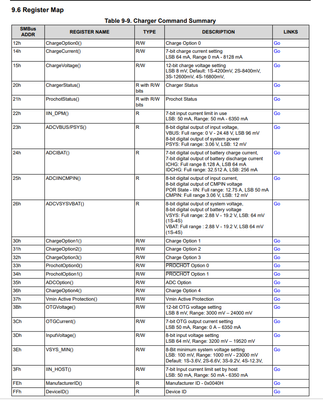

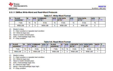

2.How to access various registers of the battery IC (BQ25720) using the SMBus protocol.

2024-09-16 2:42 AM
This part below should be put in the HAL_SMBUS_MasterRxCpltCallback()
LOG_INFO("HAL_SMBUS_Master_Receive_IT:%d%d\r\n",buff[0],buff[1]);
Could you help me?
The process is mentioned on the device datasheet.

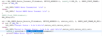

Hello @Saket_Om ,
Thank you for the insight. I tried the aforementioned snippet. Could you possibly review my code and log?
Could you kindly assist me develop?
