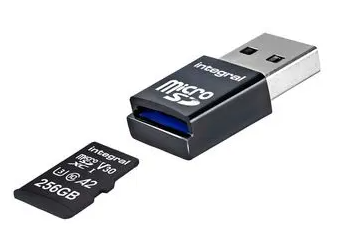

2024-05-23 7:06 AM
You can get USB "pen drives" which take a uSD card; eg,
So you could just develop a USB MSC Host - and use one of those to provide the uSD Card support ...
2024-05-23 8:06 AM - edited 2024-05-23 8:07 AM
Thank you @Andrew Neil :)
