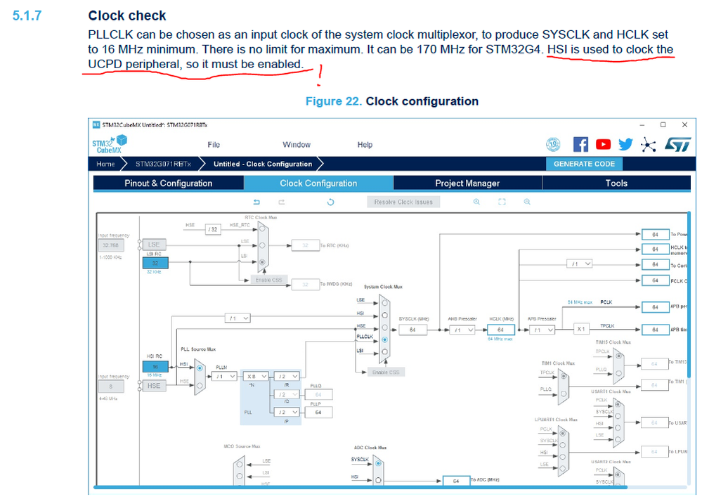

2021-12-14 12:10 AM
From the Clock Config page in CubeMX, you can choose which hardware will use which frequency and source. Both SYSCLK and USBCLK should be fed with HSE + PLL. You don't have to use HSI.

I also saw this, that means the HSI must be enable, if not the PD controller will not work normally.
I worried about the stability when the HSI running in high temperature, for example nearby the higher limit of range(-40°C to 85°C/105°C/125°C, the operating temperture for STM32g0b1rc). For the device may work in a high temperature circumstance.
But have no choice, hope it's superfluous:smiling_face_with_smiling_eyes:.
