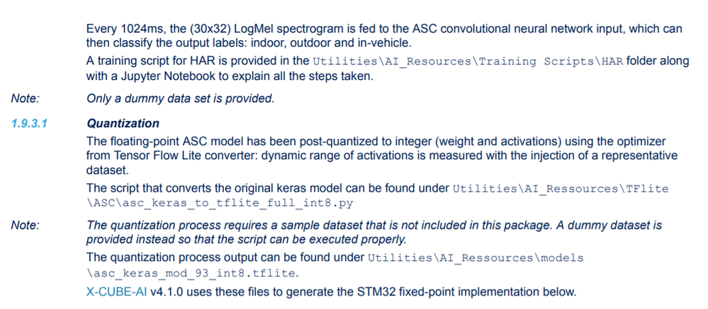

Reading the UM2524 user manual, I noted the following statements at page 14
The phrase "A training script for HAR is provided in the Utilities\AI_Resources\Training Scripts\HAR folder along with a Jupyter Notebook to explain all the steps taken." is obviously an oversight.
It seems anyway that the ASC (Audio Scene Classification) is deployed in the FP-AI-SENSING1 package as a fixed-point NN inference.
I have developed a simple two-class floating-point implementation.
Can I modify some files in the package, e.g. asc_processing.c, asc_processing.h and adapt the package to my inference? Do I need for some reason to quantize it to integer?
Do you have tips about such a challenge?

Hello M.
There is no particular challenge to adapt the current fixed point model to floating point . float is even ,in general ,simplifying the design. the code modification should not be extensive.
The main thing to take care of is the real time in case the model is too computational intensive . same for the memory footprint that will expand .
