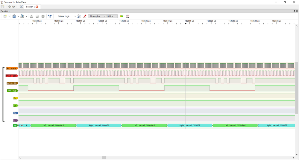

So I would've thought that I would need to use interrupts and DMA because maybe CPU can't handle that, but what puzzles me that the message is decoded correctly in a logic analyser.
That's strange indeed, possibly the I2S mode in SPI/I2S has more into it than the documentation in RM exposes.
