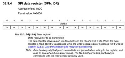

The DMA should be set up for half-word access on the peripheral side since the DR register is 16-bits.
You can keep the memory side at 32 bits, but the bytes might not be in the right order.
When it's set up as a word, it's reading 32 bits but only half of them are relevant, so you're getting double the data.

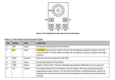

Hello @JusbeR
The microphone you are using is mono with output in sterio format.
According to the datasheet we have a pin LR that should be set to select the output on the right or the left chanel.
So it is normal that you receive the half of data as 0.

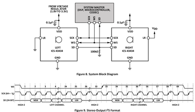

Looks like these are meant to be in stereo, with one device outputting on the left channel, and the other on the right channel. With only one device, half of the data will be 0, as you see.
If you only have one device, you could set it up to output on the left channel and use SPI to read it instead and use WS as the CS signal. Don't think there's an I2S setting to ignore half of the data or capture "mono" audio.

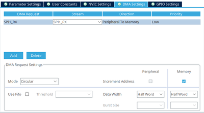

2025-05-12 12:18 AM
All right. I think I got it now by combining all the hints you guys gave me. The final clue was @TDKs half word hint. So the culprit was
- Use half word DMA setting even if you use word memory block
- Swap the half words (as in not Little/Big endian swap, just swap the half words)
- Give HAL_I2S_Receive_DMA the actual count of words in the buf not half words
Here some screenshots and code for future reference
static inline int raw_to_sample(uint32_t dma_raw) {
return ((dma_raw & 0xFFFF) << 8) | (dma_raw >> 24);
}static uint32_t dmabuf[128]
HAL_I2S_Receive_DMA(h, (uint16_t *)dmabuf, 128);This way you when you get the half full interrupt you will have data in 0-63 where left in even and right in odd numbers. After full interrupt data is on 64-127.
