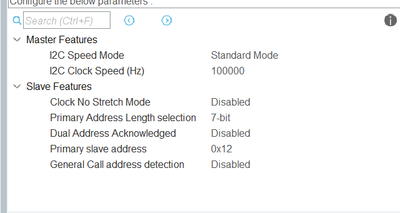

2024-02-07 2:04 AM
I am using a basic I2C Configuration as seen in this screenshot. The connection to the Raspberry Pi is simply wires connecting SDA, SCL and GND Pins. The Raspberry Pi has its own pull up resistors.

2024-02-07 2:10 AM
You need to check the wire continuity between the two boards (SDA, SCL and GND) , it could be also something related to the wires themselves ..
