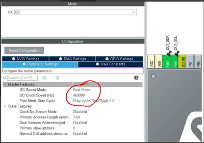

2023-11-16 1:05 AM
Hello again @Anil3
Just let's try to change your configuration to this:
Thx
Souhaib
