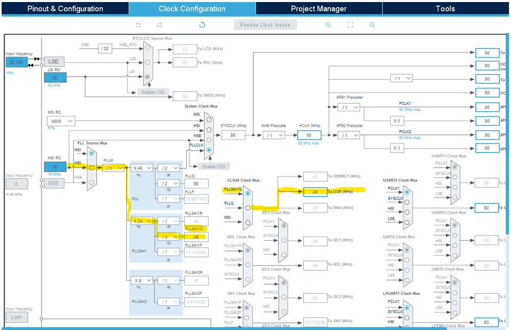

It looks like there is missing some of the settings that showed in STM32CubeIDE.
Created a project with a usb serial just to get the autogenerated setting for zephyr.

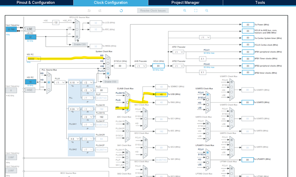

&clk_msi {
status = "okay";
msi-pll-mode;
msi-range = <11>; /* to get 48MHz */
};2023-03-14 6:20 AM
