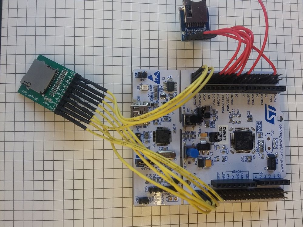

You should take a look at this:
https://01001000.xyz/2020-08-09-Tutorial-STM32CubeIDE-SD-card/
And use the drivers that are linked in that post with the fatfs middleware. I got it successfully working on an stm32l476rg-nucleo with an SD card break out board from adafruit.
