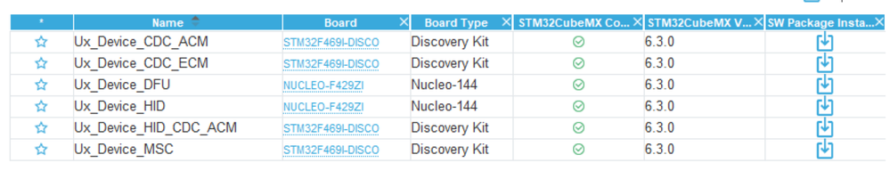

Hi @olebenny ,
Many examples project that use Azure RTOS USBX are available in CubeIDE as shown in the below figure. For more explanation, I advise you to follow these links to know how to use the USBx for AzureRTOS applications:

2022-06-19 7:03 AM
Hello Kaouthar
Thank you for responding.
I am using STM32 Cube IDE v1.9.0 and STM32 Cube MX V 6.5.0.
If I select the USB example Ux_Device_DFU for NUCLEO-F429ZI I get the 'old' USB-code, that works with FREERTOS, not the Azure_RTOS + USBX.
Unfortunately, Azure_RTOS and USBX are not part of 'my' Cube MX for direct selection, I have to select it through 'Software Packs --> Select Components'.
Here I can select 'STMicroelectronics X-CUBE_AZRTOS-F4' and in that sub-tree, I can select 'RTOS ThreadX' and 'USB SUBX'.
I have already succeeded doing this with 'RTOS ThreadX' for NUCLEO-F429ZI as well as our own STM32F417 board by following this article:
How to create a Thread using AzureRTOS and STM32CubeIDE?
It describes in easy understanding steps what to do with Cube MX and Cube IDE.
