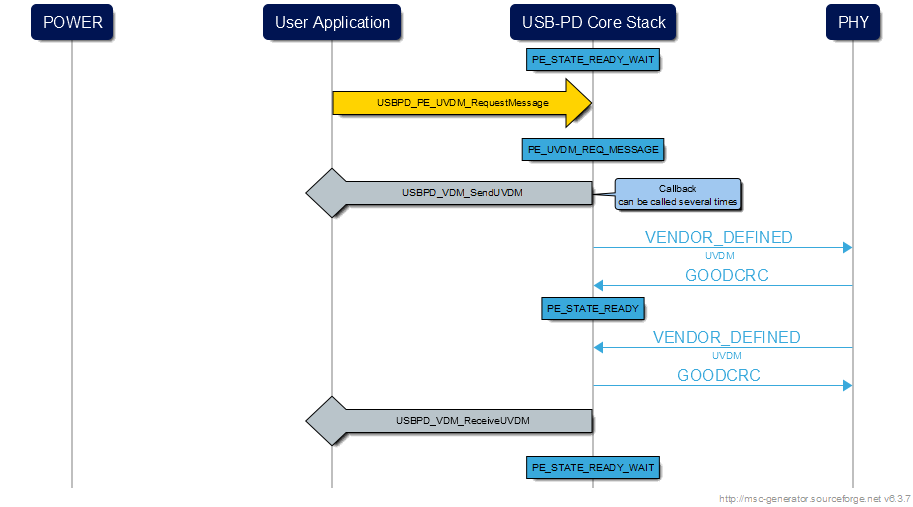

Dear @NathanWolcott
Please find the associated Message Sequence Chart:
Link to collision avoidance in PD3.0, there is a delay in the stack before really sending the UVDM message. It is why the callback is called several times.
Before sending a new message to UVDM, you should wait for notifications of the stack that you are in ready state (notification 'USBPD_NOTIFY_STATE_SRC_READY').
Maximum of VDO for a UVDM message is set to 7 (1 UVDM header + 6 other VDO).
Then maximum size of pVDO is 6. pNbData is this number.

2021-08-30 12:34 AM
Dear @NathanWolcott
