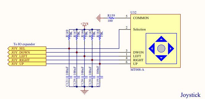

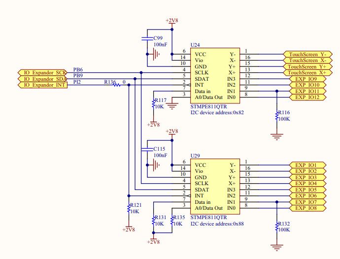

I'd like to read the state of eval board's joystick with i2c. CubeMX connects I2C1 to B6 and B9.

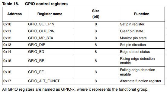

STMPE811 where the joystick is connected is at address 0x88.
STMPE811 port expander has address 0x12 for monitoring GPIO pin state.
