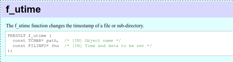

2023-05-15 9:34 AM - edited 2023-11-20 5:27 AM
in fatfs by chan... ->
http://elm-chan.org/fsw/ff/doc/utime.html
+++ set in cube: fatfs -> set defines !!! ->

2023-05-15 3:19 PM
I already found this link in Google, there is nothing to help me solve the problem.
