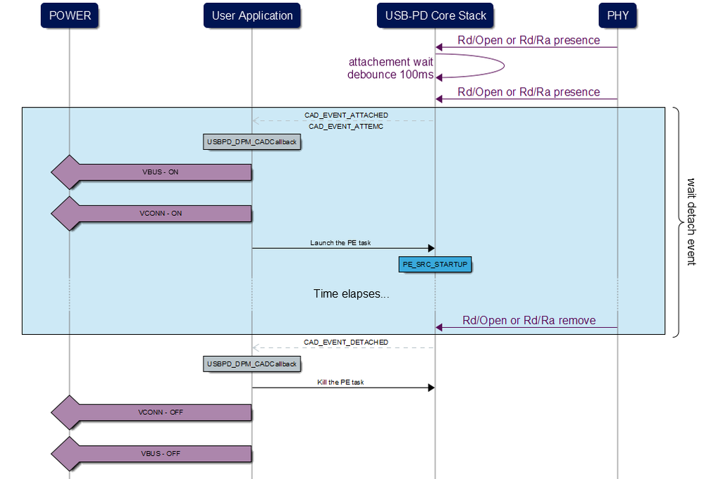

Hello, what is the voltages you see on CC lines? I suggest you also to refer on our User Manual UM2552 and check the source connection procedure described in Figure11:
And also remind that you can add your own traces, also described in the same document (3.6.4 TRACE system):

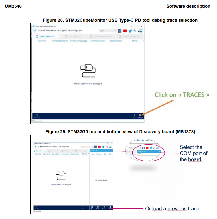

in the projects we deliver, the internal trace is enabled. It is possible to see if you have communication between 2 boards.
Trace is done through USART pins connected to ST link. You should use Cubemonitor-UCPD and use the functionality described in the following image:
