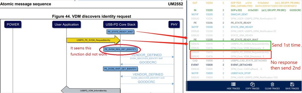

2023-07-01 8:10 PM
Here is the trace, it seems PE_SVDM_REQ_GET_IDENTITY did not work.
Any idea?
