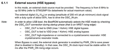

Regarding STM32MP153 advanced Arm<Sup>®</Sup>-based 32-bit MPUs - Reference manual point 10.4.2 HSE Oscillator.
Our hypothesis was that ROM Code failed to configure HSE Bypass because a 1K Ohm impedance was required to be connected to Vdd or GND in PH1-OSC_OUT pin.
This information is also specified in Getting started with STM32MP151, STM32MP153 and STM32MP157 line hardware development - Application note point 6.1.1

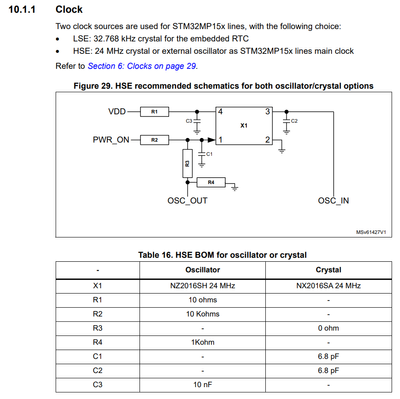

There is another key point. It may be mandatory to give the processor the capability to turn on/off HSE clock.
At point 10.1.1 of the same document (related to clock configuration)

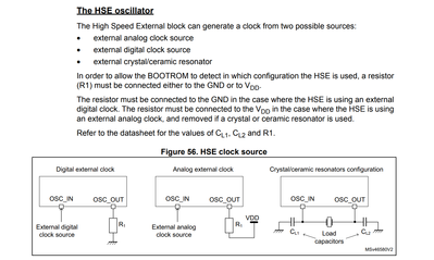

Thanks PS-PabloGS. We had the same problem but on the L151. If it helps anyone else, on the STM32L151 if using an external oscillator (HSE in bypass mode) the bootloader doesn't seem to handle this so you need a pulldown resistor (1k?) or pulldown cap (20pF?) on PH1 OSC_OUT. I think the L151 bootloader uses HSE in analog mode, expecting to see a crystal on both pins, so adding the pulldown on OSC_OUT should allow it to use an external oscillator only connected to OSC_IN without bypass enabled and it should detect the correct frequency.
