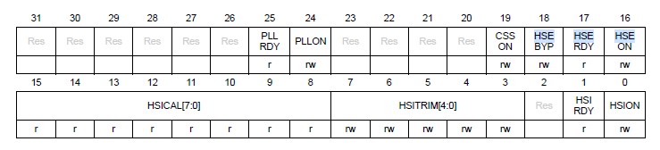

based on your advice "are you able to connect using SWD to your board running in bootloader (connect to running target) and read out PLL setting done by system DFU bootloader.", did some tests and here is what I retrieved :
* On the discovery, working DFU bootloader over USB, register RCC_CR reads 0x030b5783. Not sure how and why it detects an HSE as crystal is not mounted ...
* On my board, DFU bootloader running allow for UART bootload ! It confirms the bootloader is working but most probably does not detect the clock correctly.
* On my board, DFU bootloader running but no working USB, RCC_CR is 0x03004b83. Meaning that HSE is off as well as the bypass. Probably the bootloader does not detect a crystal and continues on HSI instead.
* On my board, if I change RCC_CR from 0x03004b83 to 0x01054b83 in the debugger (setting HSE on, bypass on), it ends up with 0x03074b83 (meaning the HSE turns to ready). It confirms that when bypass is enabled the HSE is correctly detected and set to ready.
* On my board, resetting the chip does not fix the issue, so it is not a race condition on external clock power on.
So if my analysis is correct the bootloader indeed does not enable USB because it runs on HSI instead of HSE bypass (not supported ?). Can you confirm my analysis ? Any way of forcing it to HSE with bypass or it is 100% boot rom without possible forced configuration ?
