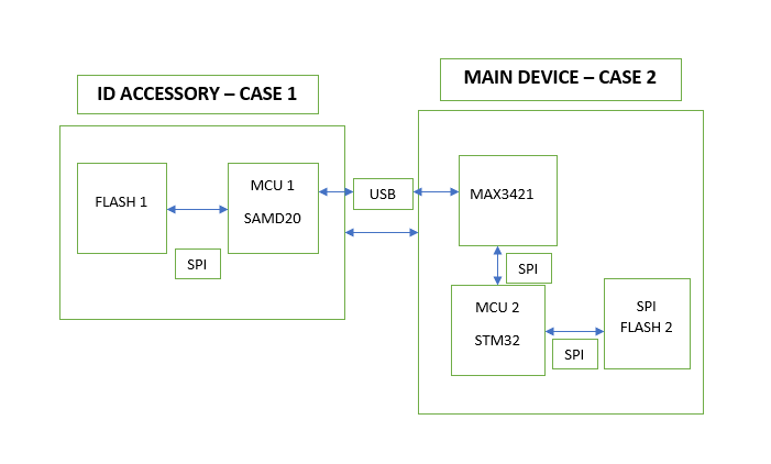

Actually the block diagram will be of this kind:-
1) ID accessory(Kind of pen drive- not actually a pen drive) ----> NRF52840.
In case 1 STM32 should act as a USB host and detect the ID accessory as well as do some data transfer. So we are using MAX3421e which will support host operations.
Help needed for CASE 1.
STM32 will have to fetch data from the FLASH 2 and send this raw data to MCU 1 via MAX3421.
1)For this which USB stack will be needed is my question?
2)In the library which I shared above I have seen the code for detecting USB and enumerating it. But how to send data to the MCU 1(samd20) and how to receive data from MCU 1(samd20)?? I am confused on that.
3) How will USB drivers in case 1 be used with SPI drivers?
Thanks & Regards,
Snehal

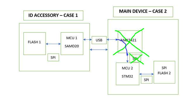

As @AScha.3 said, use the native USB peripheral included in your stm32.
It would be easier and you use one chip less.
If they dont have a very good reason to use MAX3421, they just made your life 100x more difficult, and you look like you dont have a lot of experience already, chances are after a couple of months of pain they end up changing the HW design after you quit.
Trust me on thisone.
Help needed for CASE 1.(this is a STM32 forum, maybe you should ask this question in a mmicrochip forum)
I have never used this MAX3421,beacuse stm32f103 already has USB.
I would bet the SAMD20 should use the (Mass storage device USB profile/stack)
Why dont you ask to the creator of the library?
I never used a SAMD20 , but i do believe MAX3421 is transparent to USB, so no SPI anything in SAMD20.
