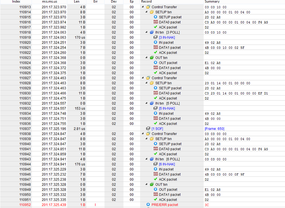

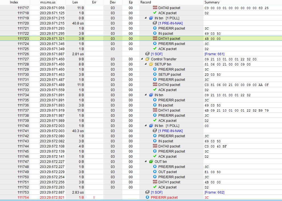

I managed to get my Hands on a beagle 12 USB Protocol Analyser. I was able to catch the Error with this very useful tool:
one picture shows the error after the first Pre PID was send. The other pictures shows the error a bit later after a few successful transfers. But everytime the PRE PID is the last information send by the Host before the Host gets shut down completly. There are no SOF or anything else coming from the Host..

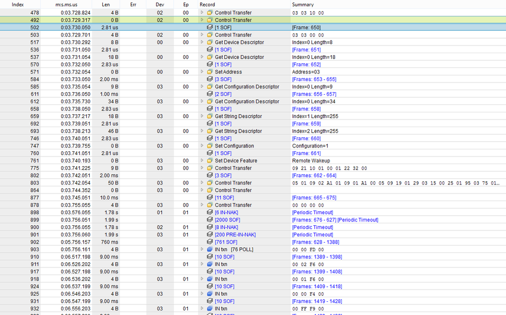

Well Jan, don't ask me why it is working sometimes. Looking at the trace of a successful enumeration shows no difference in timing compared to a failed enumeration:
(I'm connecting a low Speed Mouse over 2 HUBs with the STM32)
Because of the fact that I got it working sometimes I thought it might be a simple timing error. But this trace says a different thing to me.

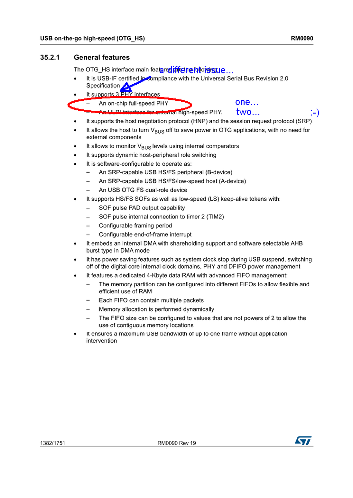

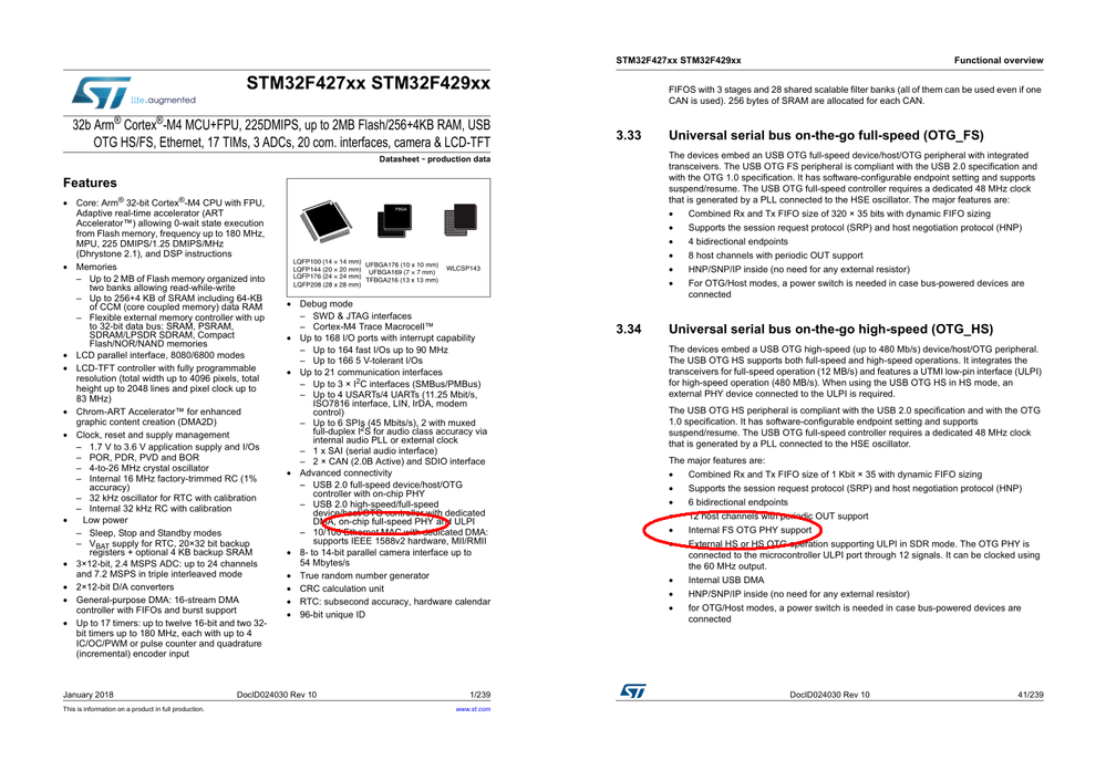

I don't like the formulation, what is "full-speed interface", is it the internal FS PHY or external ULPI PHY In FS mode?
What's wrong with calling the internal FS PHY... well... internal FS PHY?
Errata should be unambiguous and should use terminology introduced in DS/RM:
The naming and description of OTG modules and especially this detail (i.e. presence/usage of internal FS PHY), while fairly well described in 'F4 materials, is very badly treated across other STM32 families (I've complained in the past, but honestly have no energy to look it up nor summarize it again). Please don't make it worse in the Errata.

@Community member , my assumption is that we opt for this formulation "full-speed interface" in order to be some how generic across the various families.
I understand from your feedback that this is not the good approach. Thanks for sharing another vision that I'll escalate internally on my side.
