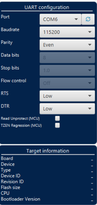

2024-12-06 7:21 PM
Regardless of the unliklihood that this will be responded to by the current thread posters, I will continue trying to push for this solution to be found for future applications for whoever might need it.
As I read the thread I was taking the exact same steps before finding this thread.
So if anyone can assist in trying to figure out how to program an STM32 Nucleo L053R8 through a USB to UART converter that would be great, I have already followed the steps above to try to get to the solution.
In this image I have screenshotted the settings that I have in my programmer. Everything else as described in the previous message in this thread has been followed as well. I am still getting the same error as the original poster which is:
21:06:50 : Error: Activating device: KO. Please, verify the boot mode configuration and check the serial port configuration. Reset your device then try again...
