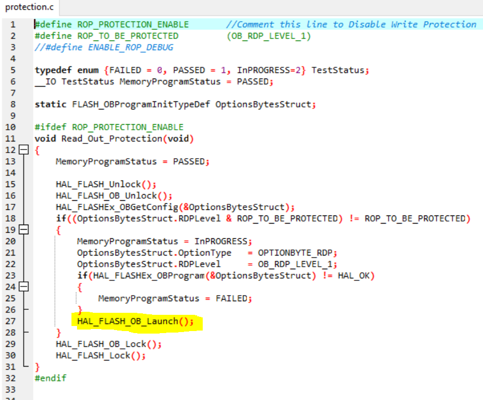

2019-05-10 7:55 AM
Thanks for the reply,
I have implemented in program, It works the way you have suggested.
Please check the image.
The only question I have is after executing HAL_FLASH_OB_Launch() I am not able to do further debugging.
While debugging the code for the first time once the above mentioned function is executed then I am not able to do further debugging,
Is it because the option bytes are loaded and even then dynamic debugging is not possible.
Please confirm your view.
Thanks once again for all the support.
