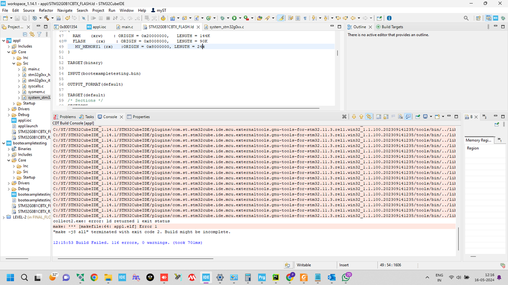

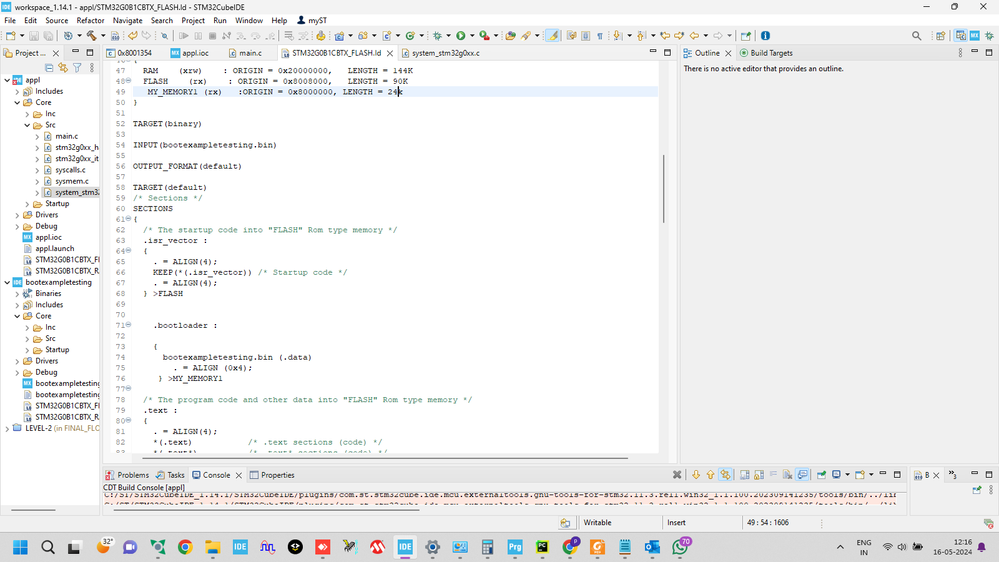

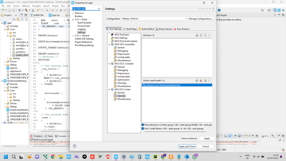

i have modified in the linker script of application
in application adding linker pathpleppl
error
2024-05-16 12:41 AM
PLEASE CHECK THIS ERROR
make -j8 all
arm-none-eabi-gcc -o "appl.elf" @"objects.list" -Wl,--start-group -Wl,--end-group -mcpu=cortex-m0plus -T"C:\Users\91910\STM32CubeIDE\workspace_1.14.1\appl\STM32G0B1CBTX_FLASH.ld" --specs=nosys.specs -Wl,-Map="appl.map" -Wl,--cref -static --specs=nano.specs -mfloat-abi=soft -mthumb -Wl,--start-group -lc -lm -Wl,--end-group
C:/ST/STM32CubeIDE_1.14.1/STM32CubeIDE/plugins/com.st.stm32cube.ide.mcu.externaltools.gnu-tools-for-stm32.11.3.rel1.win32_1.1.100.202309141235/tools/bin/../lib/gcc/arm-none-eabi/11.3.1/../../../../arm-none-eabi/bin/ld.exe:C:\Users\91910\STM32CubeIDE\workspace_1.14.1\appl\STM32G0B1CBTX_FLASH.ld:78: ignoring invalid character `\342' in script
C:/ST/STM32CubeIDE_1.14.1/STM32CubeIDE/plugins/com.st.stm32cube.ide.mcu.externaltools.gnu-tools-for-stm32.11.3.rel1.win32_1.1.100.202309141235/tools/bin/../lib/gcc/arm-none-eabi/11.3.1/../../../../arm-none-eabi/bin/ld.exe:C:\Users\91910\STM32CubeIDE\workspace_1.14.1\appl\STM32G0B1CBTX_FLASH.ld:78: ignoring invalid character `\200' in script
C:/ST/STM32CubeIDE_1.14.1/STM32CubeIDE/plugins/com.st.stm32cube.ide.mcu.externaltools.gnu-tools-for-stm32.11.3.rel1.win32_1.1.100.202309141235/tools/bin/../lib/gcc/arm-none-eabi/11.3.1/../../../../arm-none-eabi/bin/ld.exe:C:\Users\91910\STM32CubeIDE\workspace_1.14.1\appl\STM32G0B1CBTX_FLASH.ld:78: ignoring invalid character `\215' in script
2024-05-16 1:56 AM
Some wrong character, format correcly added lines in linker script, (maybe some unprintable sign was added)
