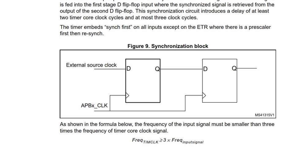

If it is a clock that used rather than APBx clock source, why it must be synchronized first?

You still have to access the TIM peripheral registers in the APB clock domain, so the clock edge that increments the counter is coherent with the APB clock, and you don't get phase issues, and setup/hold violations.

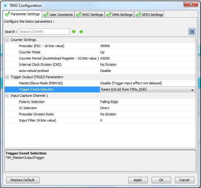

2018-06-07 4:50 PM
Thank you.
Another question that I have is that when I use input capture to measure the frequency on every capture event the CCR register is loaded with CNT, but the CNT goes on without any reset. If I want to reset it after each capture what should I do? I tried some cube mx to do this but it didn't work.
