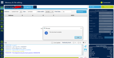

2024-03-22 10:28 AM
@Pavel A.

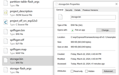

Thanks for the suggestion, followed the below steps
1. I have used the esp32 storage bin file which is been by generated with cacert.pem and confi.ini files.
2. Download it in the stm32 under 0x8001000.
Could you please give me more guidelines on the address and size ?

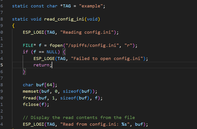

coming to the main question, In the case of esp32 here is the way to check them How can I do this in the stm32

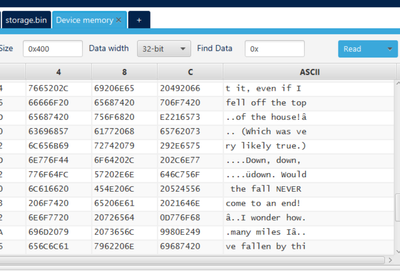

2024-03-22 2:17 PM - edited 2024-03-22 3:00 PM
Not really. It's up to you. Unleash your creativity ))
Hmm... Something like this:
void read_config_ini(void)
const char *config = (const char*)0x08001000;
const char *endptr = memchr(config, 0xFF, MAX_CONFIG_SIZE);
unsigned config_size = endptr - config;
printf("Config:\n%*s\n", config_size, config);
