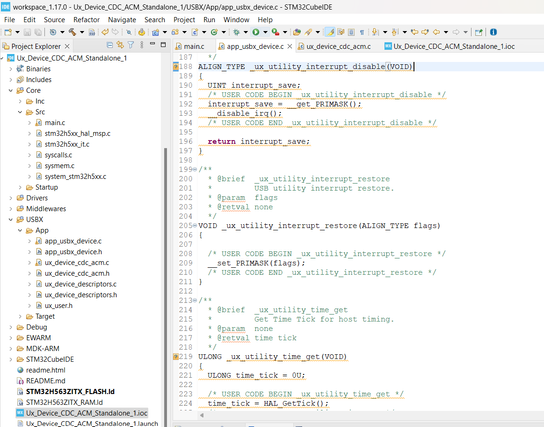

I'm trying to implement USB CDC ACM in standalone mode(without using ThreadX) on STM32H563ZI board. I have tried this with ThreadX and got it working.
I have modified the Ux_Device_HID_CDC_ACM example project, by removing ThreadX, HID and UART part to make it CDC standalone for my requirement. But its not working.
I have referred to these links:
https://community.st.com/t5/stm32cubemx-mcus/usbx-standalone-on-stm32h5/td-p/705341
I'm having few issues in these lines of code, it's showing Macro usage error, syntax error...
can anyone explain the issue.

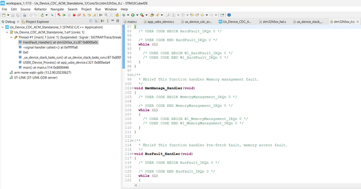

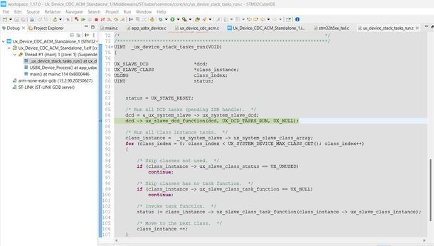

after the line 87, from ux_device_stack_tasks_run.c file, its going to hard fault...
as shown,
I would greatly appreciate it if anyone who can debug the mistake in this process and could guide the further steps to take.
