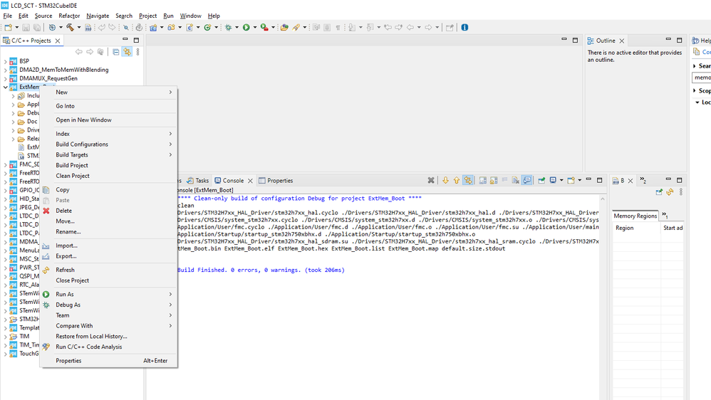

Hi and thank you for the reply.
I have opened the ExtMem_Boot project within the CudeIDE. Set the build configurations to make the *.hex file, looking to flash via the Cube Programmer.
Went on on the project with the mouse pointer and clicked the right knob and selected:
- clean project, no errors ok, continuing with the build, but build failed, get 9 errors, 11:04:28
Build Failed. 9 errors, 0 warnings. (took 575ms) , attaching the console output ...
Any idea how to fix this?
Best.
