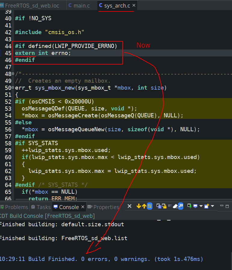

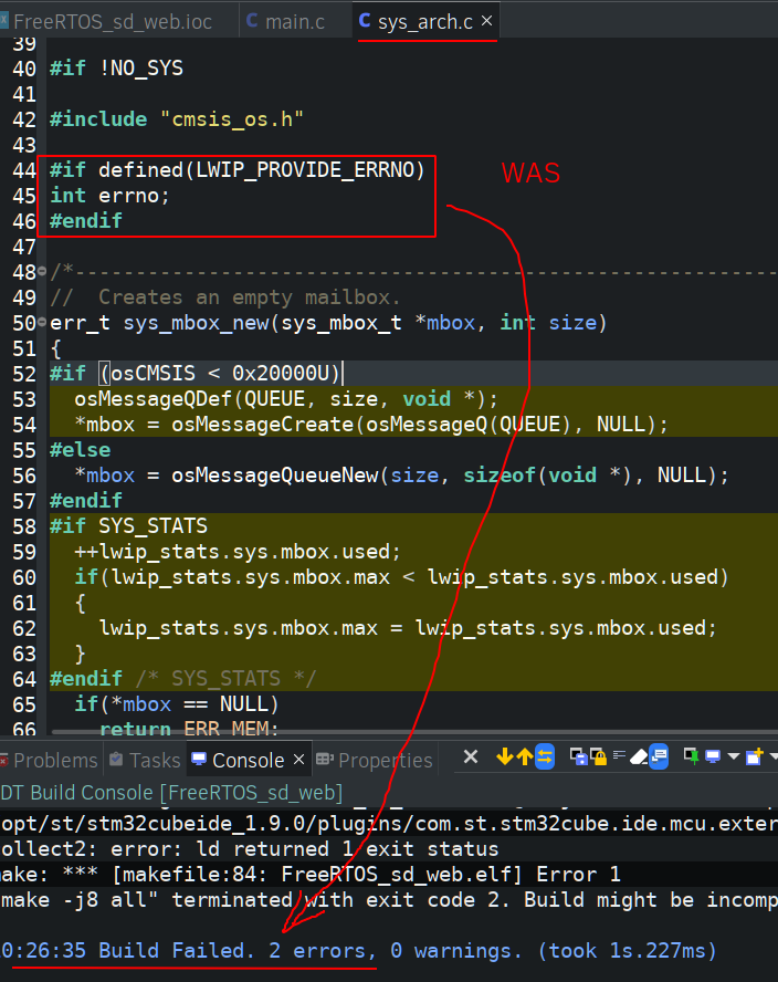

2022-03-29 12:39 AM
Thank you for the explanation but, I am not from those who can change rules in the standard libraries of 'C'.
How do I need to do it right according your mention?
Below on the screenshots, I showed the current state.

2022-04-11 3:14 AM
2022-04-11 12:05 PM
Jan's answer is the real answer. The image is only for those, who cannot read...
