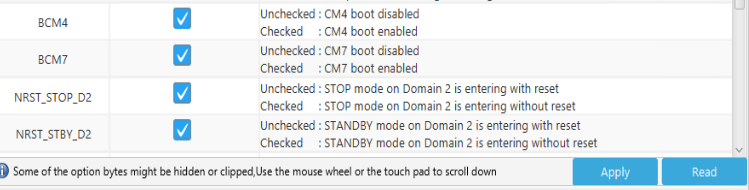

I am using STM32H745XI having Device ID: 0x450, Revision ID: V, Bootloader version: 0x90.I have pulled high Boot(pin), which is causing inbuilt bootloader to get executed. Both cores boot are enabled i.e. BCM4 & BCM7 are checked.

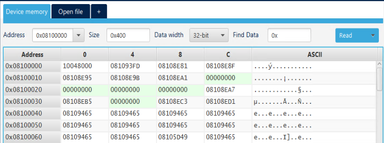

ACK is also received, but flash code is not getting executed (both 0x08000000 & 0x08100000, code are loaded).

Please check AN4221, 2.5 Go command section.
Make sure that the vector table is set correctly to point to the application address.
