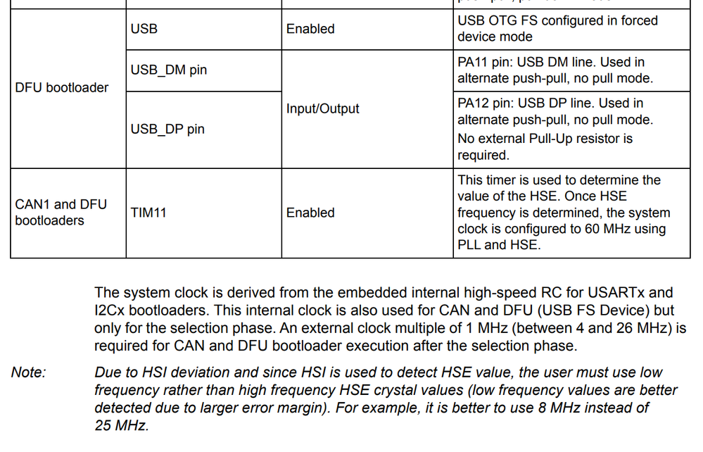

Your code is for secend test. Primary use pins and read AN2606
2022-11-21 11:24 AM
Thanks for your replies.
This is exactly what I am concerned about. Here in in the AN2606 it says HSE must be less than 26 MHz, we use 32. So does that mean I have no possibility of using the USB bootloader?
Also, I'm not sure what to do with the option bytes. Should I change what happens when the boot0 pin is low so that it runs the bootloader? How will it start my code afterwards?Is this really the recommended way of entering the bootloader from software? It seems rather complicated and not to mention risky as the document said corrupt write can cause device to lock.
